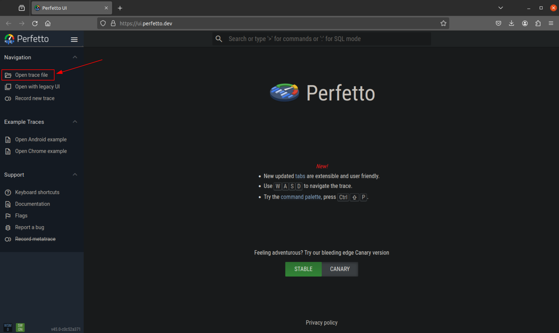

Once the perfetto trace file is collected and downloaded to the host, it can be loaded into the perfetto UI (available at https://ui.perfetto.dev/) using the option “open trace file”, as illustrated on the following image:
Detailed information regarding perfetto can be found on the official documentation available at https://perfetto.dev/docs/.

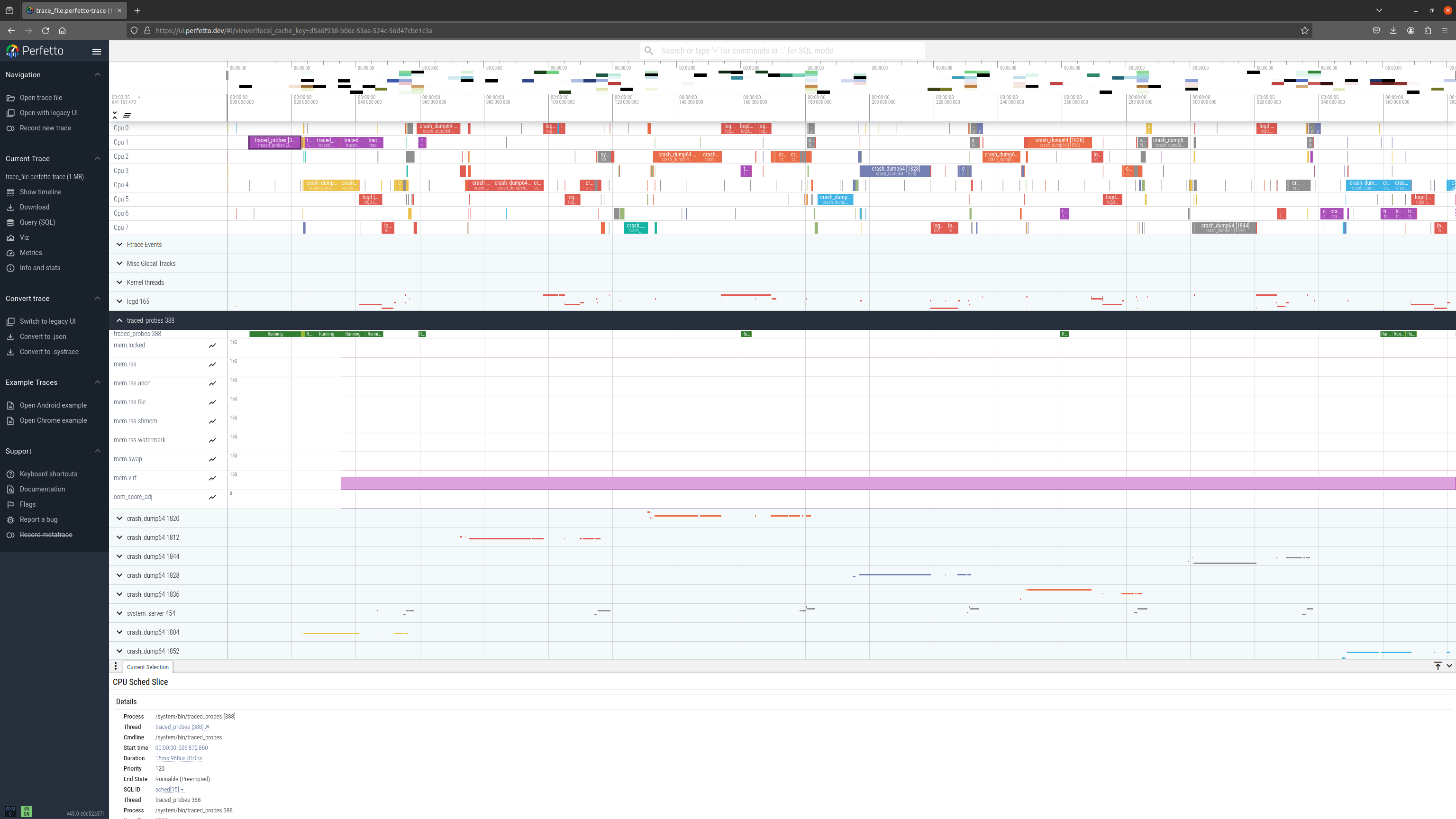

Example 1: collect ftrace scheduling events, process stats and system stats counters every 1000ms:
Trace configuration file:
buffers {
  size_kb: 16384
  fill_policy: RING_BUFFER
buffers {
  size_kb: 16384
data_sources {
  config {
    target_buffer: 0
    ftrace_config {
      # Scheduling information and process tracking. Useful for:
      # - what is happening on each CPU at each moment
      # - why a thread was de-scheduled
      # - parent/child relationships between processes and threads.
      ftrace_events: "sched/sched_switch"
      ftrace_events: "power/suspend_resume"
      ftrace_events: "sched/sched_process_exit"
      ftrace_events: "sched/sched_process_free"
      ftrace_events: "task/task_newtask"
      ftrace_events: "task/task_rename"
      # Wakeup info. Allows to compute how long a task was
      # blocked due to CPU contention.
      ftrace_events: "sched/sched_wakeup"
      # os.Trace markers:
      ftrace_events: "ftrace/print"
      # RSS and ION buffer events:
      ftrace_events: "mm_event/mm_event_record"
      ftrace_events: "kmem/rss_stat"
      ftrace_events: "kmem/ion_heap_grow"
      ftrace_events: "kmem/ion_heap_shrink"
data_sources {
  config {
    target_buffer: 1
    sys_stats_config {
      meminfo_period_ms: 100
      meminfo_counters: MEMINFO_MEM_AVAILABLE
      meminfo_counters: MEMINFO_BUFFERS
      meminfo_counters: MEMINFO_CACHED
      meminfo_counters: MEMINFO_SWAP_CACHED
      meminfo_counters: MEMINFO_ACTIVE
      meminfo_counters: MEMINFO_INACTIVE
      meminfo_counters: MEMINFO_ACTIVE_ANON
      meminfo_counters: MEMINFO_INACTIVE_ANON
      meminfo_counters: MEMINFO_ACTIVE_FILE
      meminfo_counters: MEMINFO_INACTIVE_FILE
      meminfo_counters: MEMINFO_UNEVICTABLE
      vmstat_period_ms: 100
      vmstat_counters: VMSTAT_NR_FREE_PAGES
      vmstat_counters: VMSTAT_NR_ALLOC_BATCH
      vmstat_counters: VMSTAT_NR_INACTIVE_ANON
      vmstat_counters: VMSTAT_NR_VMSCAN_WRITE
      vmstat_counters: VMSTAT_NR_VMSCAN_IMMEDIATE_RECLAIM
      vmstat_counters: VMSTAT_NR_WRITEBACK_TEMP
      stat_period_ms: 100
      stat_counters: STAT_CPU_TIMES
      stat_counters: STAT_IRQ_COUNTS
      stat_counters: STAT_FORK_COUNT
data_sources: {
    config {
        target_buffer: 0
        process_stats_config {
            scan_all_processes_on_start: true
            proc_stats_poll_ms: 1000
duration_ms: 1000
Perfetto UI visualisation:

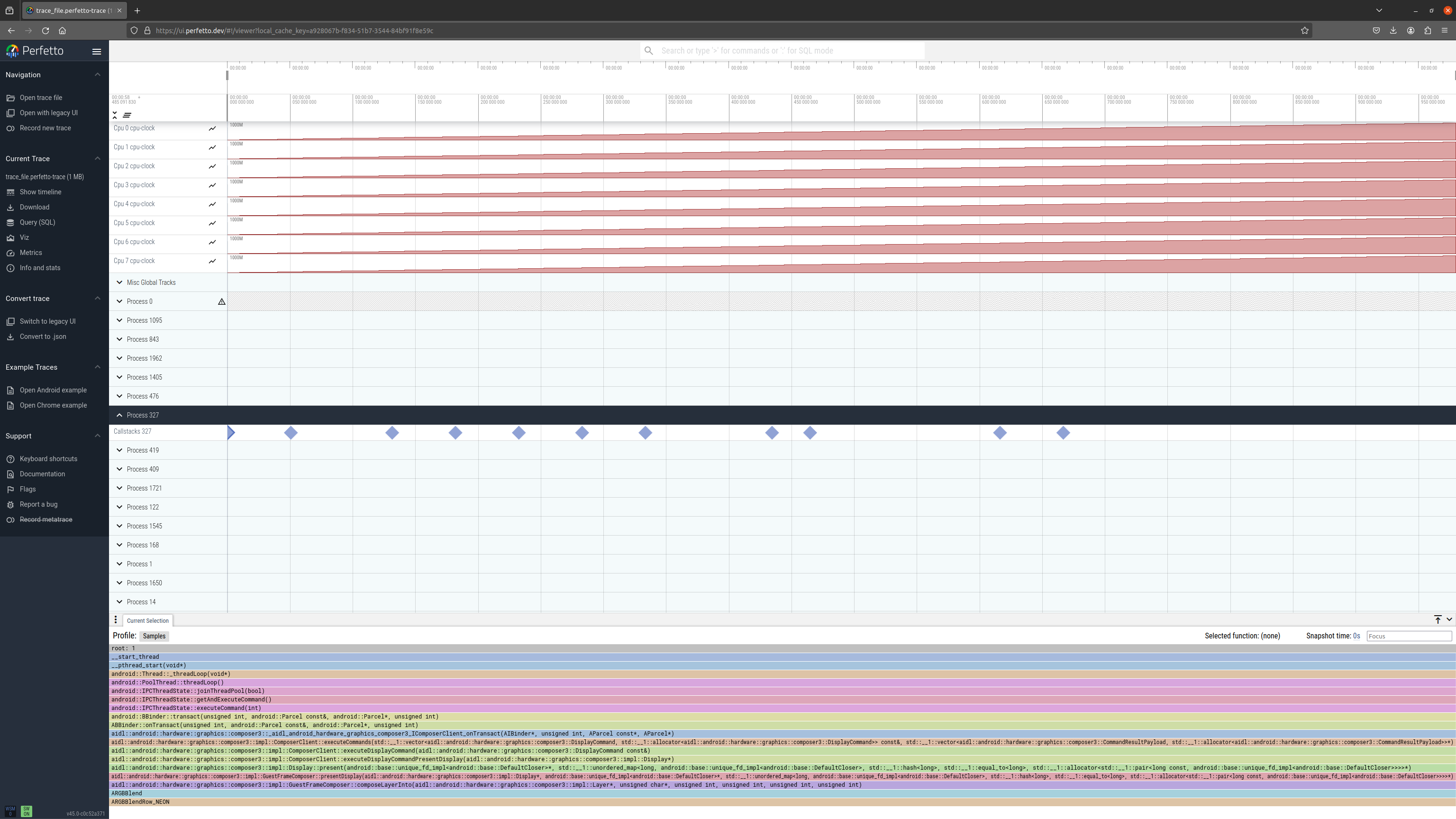

Example 3: call stack sampling of processes:
buffers {
  size_kb: 10240
data_sources {
  config {
    target_buffer: 0
    perf_event_config {
      timebase {
        frequency: 99
        timestamp_clock: PERF_CLOCK_MONOTONIC
      callstack_sampling {
        kernel_frames: true
duration_ms: 1000
